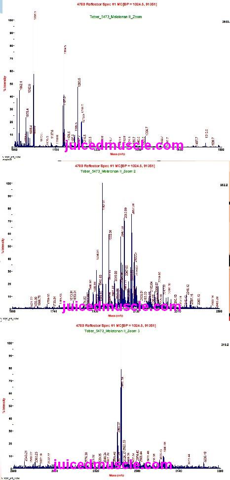

As you can easily see, the main compound has a MW (Molecular Weight) of 1024.5 Da (Dalton) which is in accordance with the cyclic peptide.
	.jpg)
However, there are a high number of minor contaminations in the sample which you see better in the zoom pictures.
You can see 1050-1550 MW – 1550 –2500 MW and the last graph is 2500 –3300 MW.
The contaminations all look like peptides but without MSMS we cannot determine their sequence.
If I wanted to know their sequences, we had to run the sample on LC-ESI-MSMS.
But this was to expensive to do for the results I could expect. It’s a reasonable product that will bring the user the effects he expects and paid for, but no pharmaceutical quality.
