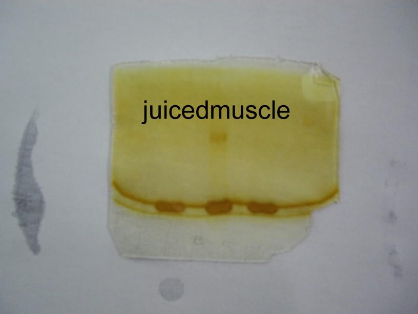

The electrophoresis shows some containments. Also vagely visible on the graphic of the sample at the 16th and 18th minute.
